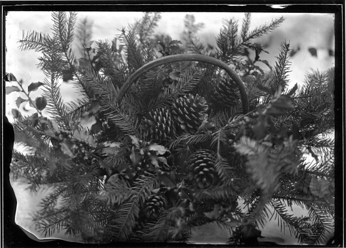

hey all,
my second glass neg of all time here!
i am very happy on how well it came out.
i used my positive collodion chemicals to make this negative.....i did not want to mix up negative chemicals and i may never have to!
i printed this on ilford warm tone paper. (please note my other neg from this morning i replaced with a picture scan. go check it out now! it is even better. you may have to refresh your page)
rosendale ny
century universal 8x10 with 5x7 reducing back. 12 inch TR f7
35 sec @ f7
collodion. sugar developer. KCN fix
ilford warmtone. MG
I don't know, Eddie, it doesn't look sloppy enough. People might not believe it's wetplate.
That looks great. Not sure you'd gain anything by switching your collodion mix.
It looks pretty good to me Eddie. Nice job.
