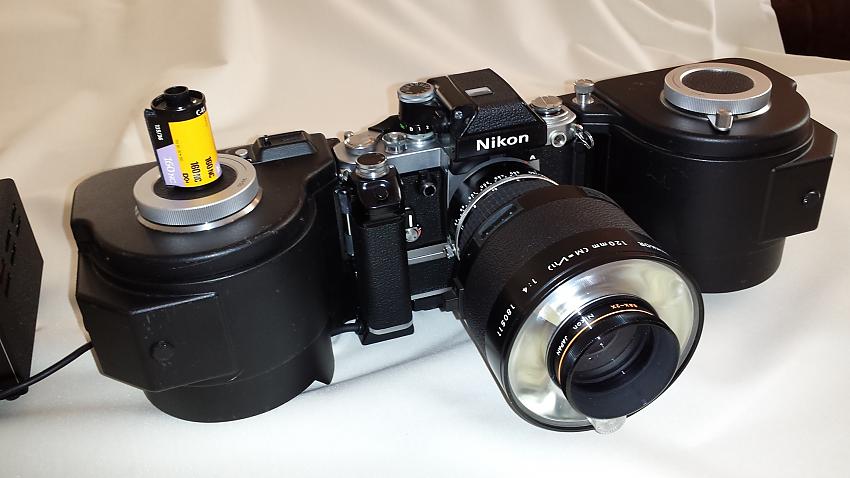

Nikon MF-2 film magazine back with Nikon Medical lens (120mm)
This setup was used for a research lab work. Using an MT-2 Intervalometer, it recorded images for subjects once every 15 minutes for an entire week without running out of film. The film magazine has the capacity of 750 pictures. The MF-2 requires an MA-4 AC/DC converter to run, and an MC-2 cable to connect to MA-4 to the MF-2
The MF-2 has been called "Might Joe Young" by some websites. It is not to be confused with the much smaller, and more common 250 film capacity back, the MF-1.
Nikon F2A, Nikon MF-2, and Nikon Medical lens 120mm
No, but it came with a small crane :smile:But seriousely, the setup was never intended to be handheld. It was mounted on a movie camera platform, along with the power supply, intervalometer, cables, and boxes of bulk film.
Oh yea, this is the prototype for the point and shoots.Send an image of it to KEH, get them all worked up.
