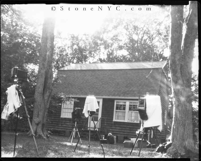

Some APUGers set up their cameras and then wandered off ... hmmm wonder if this is why there's more discussion here than pictures taken hah! :) What a fun day and a great memory!
Near and Far because it's a pinhole and "sharp" both near and far, though the wind was blowing so it's not "pin" sharp... haha
Waterford, CT, USA
11x14 Cardboard Box Pinhole, 11x14 holder, Sekonic 7xxDR Light Meter
2.5 minutes @ f/400
AGFA 11x14 X-Ray UV/G film (100 ASA) in Rodinal 1:50 for 7 minutes Rotary
Epson Scan no post scan adjustment except photo-merge
What actually happened was that all the cameras rebelled and chased the photographers away. This is a photo of their Circle of Elders!
Thanks guys!As I said in the MSA, there actually were guys standing in the shot, and a whole train walked through headed toward the beach... But this was a 2.5 minute exposure, so they are only invisible ghosts :wink:Perhaps this is the circle of elders... Or "weeping angels" of LF photography... if anyone watches Dr. Who they will understand... Good thing I was facing them, and my pinhole cover doesn't blink!
