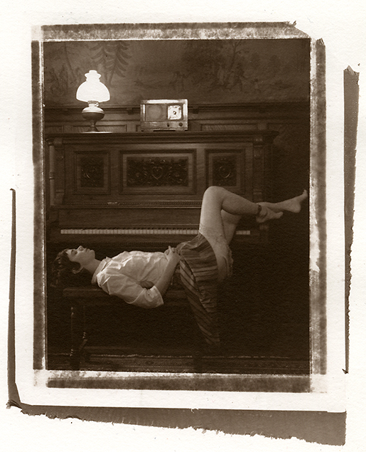

Suzie on the Piano Stool again. This time Bostick and Sullivan's Nut Brown carbon Tissue. Single transfer to COT 320, brush sized with gelatin hardened with glyoxal.
Brooklyn, NY
4 x 5 TOKO view camera, 150 mm Rodenstock lens.
NR
320 TX, D-23, two bath
COT 320
Thanks all. I'm getting excited about carbon. I suspect it's not as paper fussy as Pt/Pd, if you know what I mean.
I don't think so. Try doing it on fixed photo paper. unbelievable tones, but very hard to do down here in Florida where you have to use bags of ice to get the water cold and microwave the water because I done have hot water in my dark room for the other half. PT/PL is much easier at least for me.
how is it on PL/PT paper? do you have to size it with gelatin first.
One more thing, this image appears a little sharper than the original. I forgot to disable "unsharp mask" on the scanner. Because I'm doing single transfer at this point, I print through the film base. It makes the image just a wee bit soft.
