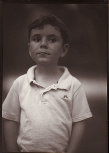

I finally have things set up to go from tripping the shutter to making a print. Would love some feedback on things I should be thinking about or changing or doing better at any point in my process, etc.
Thanks in advace.
100 ft from my front door
Century No. 2 / Petzval projector lens on Packard shutter
f4 @ 25
FP4 (iso 80) / Rollo Pyro 8 minutes
Ilford mgrc warmtone Pearl / Dektol
none

Hats of to the outdoor portraiture on LF with kids. I like this one the best. What size neg are these? I suppose I should know what size a Century 2 is but alas I dont. I like the narrow depth of field. What is the lens focal length?
Phill
Thanks Phill. The negs are 5x7. The century cameras can also be 8x10 so I should have mentioned it. The focal length is a bit of a mystery. The lens came off of an old magic lantern projector. I think Jim Galli has a couple of these and he would know better being the Master of all lenses that he is.
