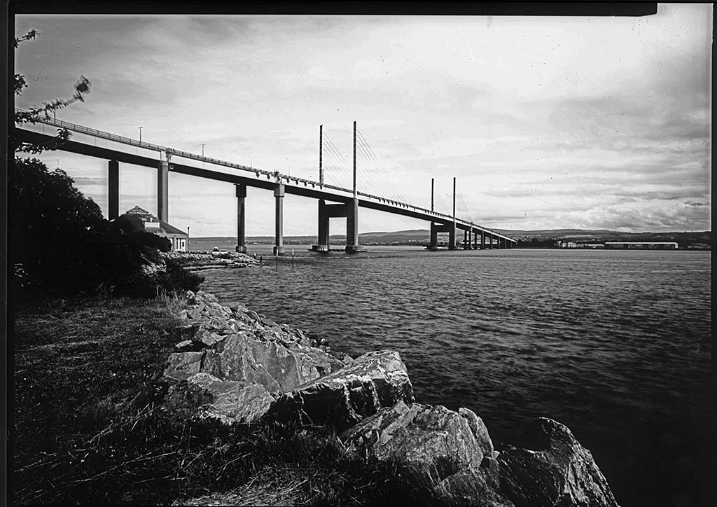

MG paper neg shot
Peter Black
MG paper neg shot
A 5x7 Ilford Multigrade RC Deluxe (aka V) shot taken on a wholeplate Kodak "B" from the 30s. No MG filter was used as I didn't have one big enough to cover the lens.
Kessock Bridge, Scotland
Kodak Model "B" wholeplate and Super Angulon 120/f8
1/2 sec at f32.5
Ilford Multigrade RC Deluxe paper negative
Ilford Multigrade paper developer @ 1:28 dilution
None
So, did you Contact Print this onto another paper OR did you 'reverse' it in software ? I would have thought the Ilford Multigrade would be too THICK to get light through to contact print it .
Hi Pete, this is a scan of the paper neg, so it has been inverted and flipped. I would tend to agree with you about the paper being too thick for contact printing, but Google suggests that it should be possible to do it. I haven't tried that yet, although that would be something to play with in the future after I make some more negs.
