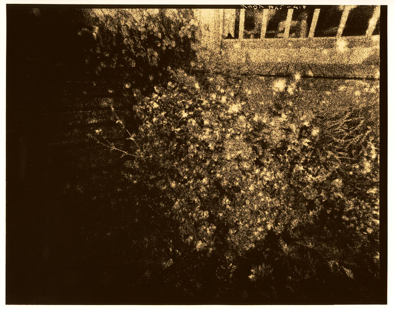

Some new lith tries with Fomabrom Variant 111/LD-20
Home
Noon Pinhole, f:250
2 sec
Fomapan 100, D-23
Fomabrom Variant 111, Lith: LD-20, thiocarbamide
Thank you for the nice comment about the print, Bertil! :smile: The temperature must have been at least 40 degrees and the dilution was 25 ml A and 25 ml B solution of LD20 in 900 ml water (this is a print made on 18x24 paper. about 16x16 cm) with no old brown. More or less constant agitation. I do this in darkness, prefering to check the print and the time with a small red light now and then.
OK, Jerevan, thanks for info, and new parameters: darkness... interesting!
/Bertil
