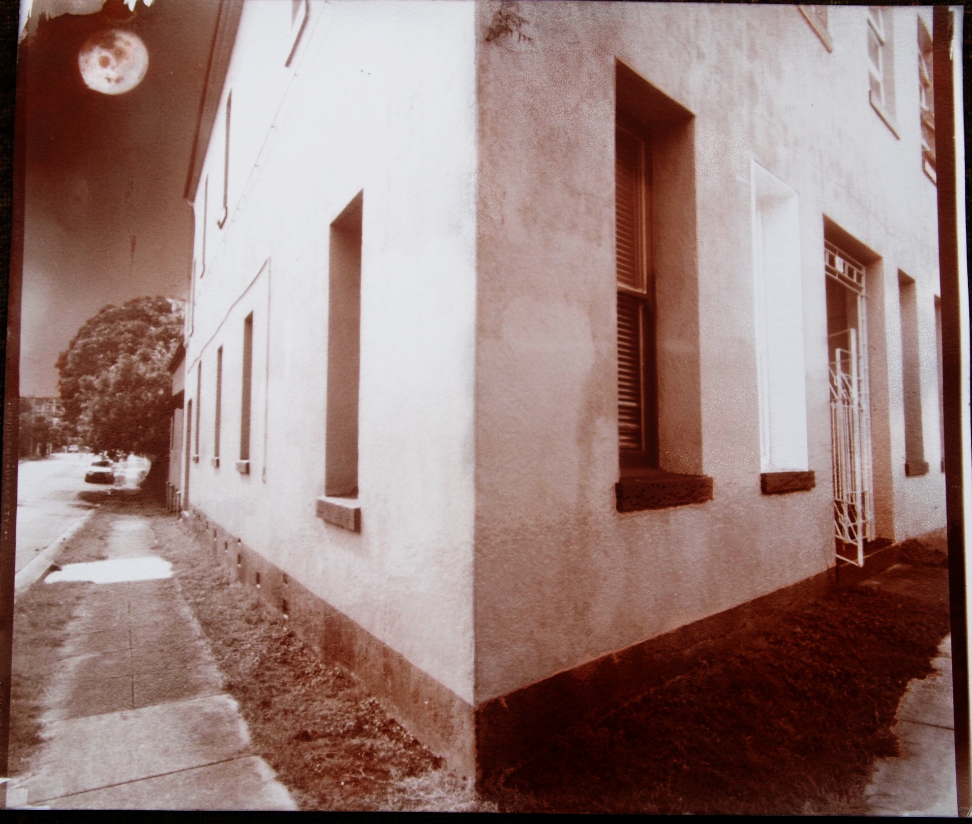

homemade 14x17 pinhole neg on Vandyke brown emulation. Masking cropping dodging and stuff. Masked the second window to look like the light was on, didn't quite work. I like my smiley moon though.
Kedron
14x17 pinhole
4mins
fuji 14x17 xray
home mixed Vandyke Brown on cheap acrylic paper
graded orange on the vertical.

@Eric Rose thanks Eric, made a negative of a moon on some transparent paper, masked out every thing but the sky and exposed the print in the sun for a bit before contact printing with the pinhole negative. ( photo was late afternoon blocked the sun with a signpost just out of shot) Only did one print, could do a something more convincing with a few more goes.....I think its given me insomnia.
