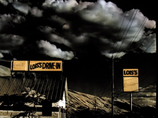

Two 16X20 liths stacked and mounted in a lightbox frame. The signs were bleached and toned first, then selenium on the bottom and gold on the top. This is best tones my P&S will produce and I don't know how to adjust on the computer, but it is pretty close.
Idaho
calumet 4X5
pretty long
Maco IR, PMK
Kodagraph TP5+, kodalith, sepia, selenium, gold.
red 29
Looks wonderful. Well done. I was unable to fully grasp the significance of two liths. Can you help me hereThanks
The TP5+ is a transluscent material, not so much as a regular transparency, but close. I made four of these prints two were too thin and too were too dense for the light frame I made. The two thinner prints stacked atop each other gave the best density. Basically, there is the plexiglass front, the mat, the two prints, a spacer, a sheet of white plexi, a spacer, and then the light board. The frame for the whole thing is 3 3/4" thick, which isn't bad. I couldn't go thinner because there wasn't enough space for good diffusion. Even here in this crappy image, you can see the difference in the 5400K lights and the super warm 3100K bulbs in the clouds. There is still a bit of a 3D effect that won't come across on the monitor. Maybe later I'll put something up on the presentation forum. Now with LED's, if you have any sort of transluscent material there are many possibilites. The big frames are maybe $50, lots of things can be culled, wall warts from Goodwill, recycled resistors, wood, paint.. The actual component bulbs are .75 each. Mats and plexi are the main expense. Anyway, thanks for looking.
