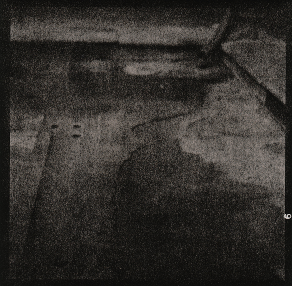

Paper: Fomabrom 111 FB
Developer: Rollei Vintage Developer (Lith) 2+1+24
Exposure: f5,6 10 sec. filter 3
Just to see what a different paper would do. Much much more grainy and less colorful than the Rollei Vintage paper I used. Less contrasty too that's why I adjusted the dilution (2+1+24 instead of 1+1+24) to enhance contrast a bit. Worked but I guess I need more contrasty negatives for this paper-dev combination.
The grain is over the top for me, it's funny but a little too. Maybe when I have a suiting photo it'll work better for me.
Development: about 6 minutes
Not yet toned
Florence
Rolleiflex T
Rollei ATP 1.1 & Kodak HC110
Fomabrom 111 FB & Rollei Vintage Lith
Hi,
it's a matter of taste.
I like the grain and the contrast you have got here.
For the right motif this combo will be great :smile:
