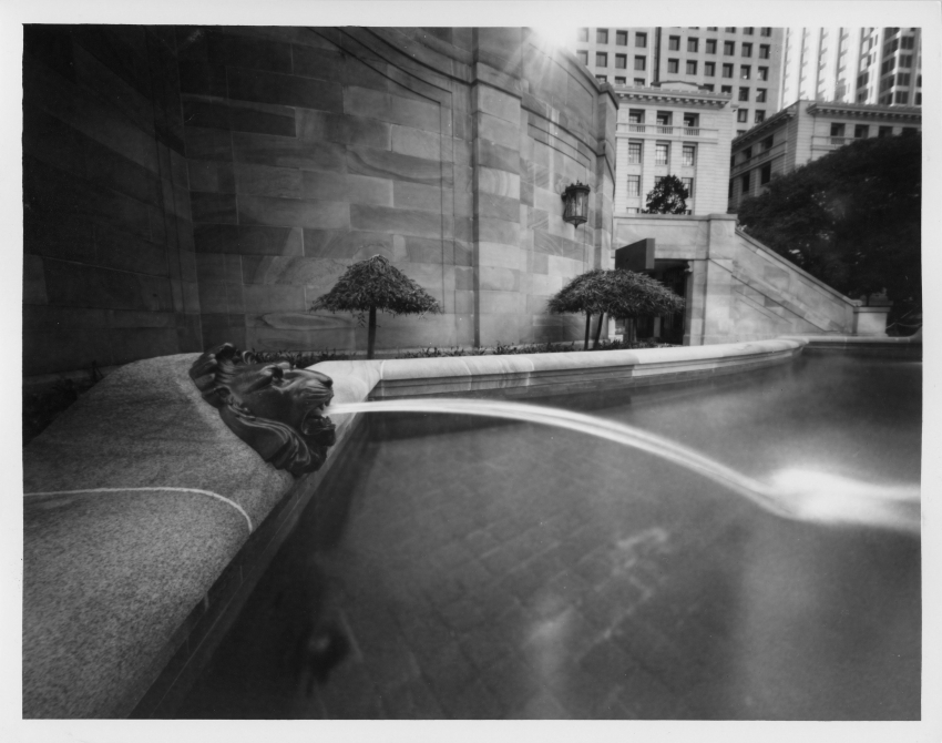

I bought me a 8x10 pin hole camera. Is 0.5mm about 4" focal length, has a very wide angle of about 100 degrees. Had to put the tripod in the fountain to get the shot. Would of liked to get a bit more of the white water. Used spot meter, calculated for f280 and added for reciprocity failure.
ANZAC Square Brisbane
A box with a tiny hole.
10 mins
foma 100, xtrol 1:1 drum roller (they are so easy to use)
fotospeed vc rc 8 x 10, very used centrabrom, then eukobrom. Dodge and burn and ferri.

Do you frame and hang, simply keep in a box or binder....what do you do with your work in order to share it? I either tack to a cork wall or enlarge to 13X19 (inkjet) and insert in frames that I re-use.
