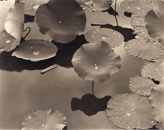

I just mounted this pt/pd print in a thank-you card I'm giving to some friends tomorrow. When I think of it I have probably given all my most cherished prints away... it kind of heavy but it also feels good :) .
Greenville, Fl (Ray Charles park)
ZnVI 4x5 210mm
pd/pt NH4-citrate Weston Diploma Parchment
Very nice Miles. Interesting you get the nice warm tones with Weston and NH4-citrate developer. Looks like a great combination.
Thanks Bert, Andrew and Ike. Good eye Ike the sort of "duotone" warm and cool tonality actually arose from an oops! Someone thinking to help me clean up poured a bit of Pot-ox in my ammonium citrate. Just before deciding to pour the "contaminated" NH4citrate down the drain I decided to at least try out on some little 4x5 prints. Turns out I like the color better than pure Pot-ox (reddish-brown)and pure ammonium citrate(cooler grays) developers. Problem is I don't know how much was mixed. Nonetheless, if you look close there are at least too distinct hues coming through.
