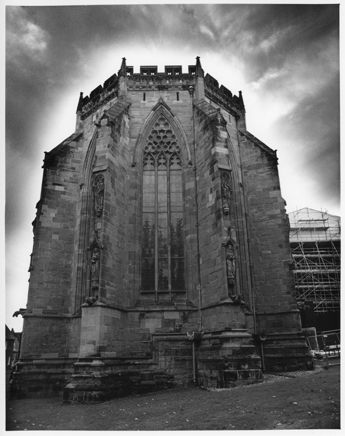

This picture was taken in dull overcast conditions in failing evening light. I could see there was some detail in the sky and attempted to bring this out with a long burn (+2.5 stops). Unfortunately the "moving hand" technique has left a halo and some overexposure to the edges of the building.
Lichfield, Staffordshire, UK
Olympus OM4-Ti, OM Zuiko 24mm f2.8
About 1/60 f2.8
Kodak TMax 400; Xtol 1+1
Ilford RC MGIV 8"x10", grade 3.5 (building) grade 4 (sky)
Yellow
Scanned and resized for posting
I have another version with less burn to the sky. The halo is less obvious but the sky is not so menacing. I wanted a foreboding mood really. I could perhaps make a custom mask but I'm not sure it's worth it as the photo is fairly boring. It is acceptable as a version with a white sky but there is little contrast in the building.
One of the most difficult burns there is. It's the kind that Ralph Lambrecht devotes a lot of space to in his book. He uses Stonehenge as the picture which has exact parallels with this picture. Needless to say it's a complicated procedure. I suspect it could be done with "waving hands" after about 3 x100 boxes of paper - minimum :D
@pentaxuser It was fun making shadow puppetry! It will be back in Lichfield next June so maybe the light will be better next time. I was at a conference and the last lecture of the day sounded so boring I skipped it and went to take some photographs. My punishment for this sin is that the light had all but gone!
Custom mask would work well, the outline of the cathedral is not so bad. You can make one exact mask and one paper cut-out which you put at 1/3 of enlarger height and split your burn half/half... I'd think its worth it.
@ Fraunhofer. OK. So how would I make my masks? If I project the image on to the easel I can copy the outline of the cathedral and then cut out the mask but this would be an exact mask that would have to sit on the paper. I could make a smaller mask by bringing the enlarger head down and following the same procedure. How then do I use the two masks?
The original size mask would be used directly on the paper for say 1/2 of the burn and the smaller mask would be hand-held above the paper for the second 1/2 of the burn with a bit of movement, fixing any sharp edge artefacts you made with your first mask. It's a bit fiddly, but doable. Note, make the smaller mask first, because the larger mask has to be quite exact, so you would not want to move the head after you've made that one.
@Fraunhofer Thank you. I will give it a go next time I'm in my darkroom. Maybe next weekend. For the photograph above I burned in the sky with a higher grade to give it a more angry look (and because there is not much contrast in the sky). I have heard that burning in with a softer grade can make the burn less obvious. Do you think it is worth trying that?
Yes, I burn sky typically with a very soft grade 0 or 00. BTW, you can also do a three way split of your burn time and do 1/3 with your free hand.
Just to be clear, I did not invent all that, most of if is well described in Tim Rudman's Master Printing course, but it does work. The first time you try it, you'll gonna use 10 sheets or so, but the second time you can have it down with 2-3 sheets. I find it very rewarding.
Thanks. I do have that book. I must find it! Edit: found the book. I’m away for a few days. I’ll make it my bedtime reading.
