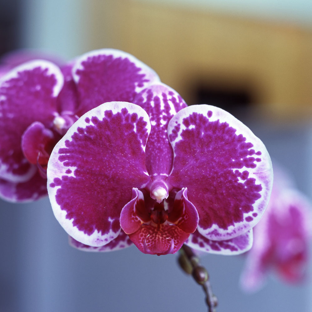

During stay-at-home I decided to try something new - macrophotography. Mary's orchid in north window light with 3-year expired Velvia 100. Incident metered and adjusted based on the bellows extension indicator in the Mamiya viewfinder. I have a few more 35mm. to post later.
Family room
Mamiya C-33, 80mm, paramender
Velvia 100
Neg scan.

Contrast, levels, crop, dust, dust, dust in Photoshop Elements.

It looks very good, Peter. At close range and in the gorgeous colours of this orchid as rendered by Velvia, it is both realistic and yet almost abstract.

Pentaxuser - The experience for the first time of filling the viewfinder with just one flower was amazing. It's also been several years since I broke off my love affair with Velvia, and even after telling myself it's just to use up the old expired film, this seductive lady has been pulling me back. I know it can't end well, but... We men are such fools.
Great shot! You really nailed the exposure- pushed up to the whites without losing detail, and maintained the coloring. In a digital capture you could risk saturating the sensor both in the whites and in the color. Just out of interest- how much bellows did you use, and how open were you? The bokeh is very smooth, and it does not look wide open.
Markwyatt - Thank you. It's about f16 or f11 from 6-10 inches away. Bellows adjustment came to 1 or 1.5 stop. 1/2 second, maybe? It's illuminated by a large window 2 feet behind me with reflected northern noon-day light on a crystal clear Colorado day. Sort of the world's largest soft box. Yes, one thing that's really nice about the 80mm Mamiya lens is how buttery the out of focus areas are. The black thing in the background is a microwave about 15 feet away.
