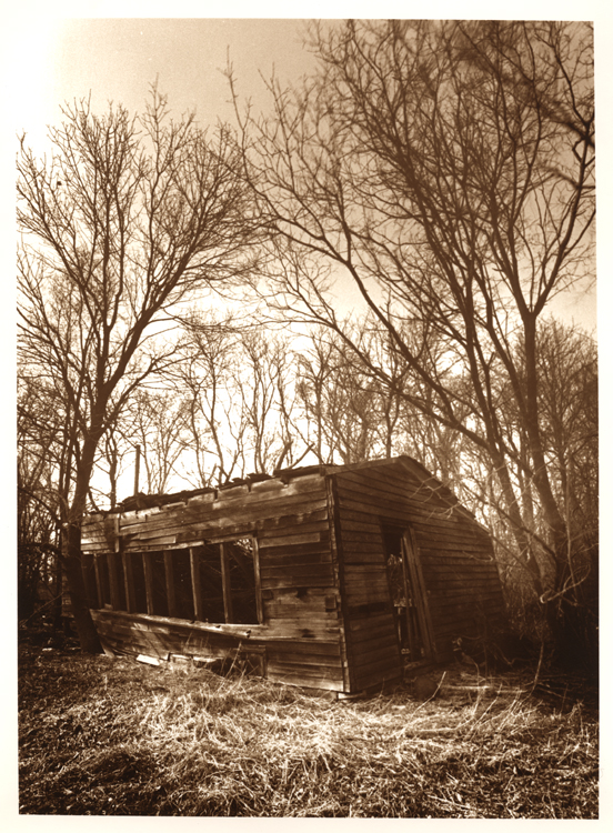

Leaning Shack
Leaning Shack
All that remained of old farmsted in western MN
Efke KB25 Orange Filter R09
Split Filer and printed too dark on Ilford MGFB warmtone matte in Dektol 1:1
Became my first attempt at toning.
Bleached till only shadows remained and toned in Kodak rapid sepia toner.
western MN highway 7
F3 HP 35mm
F8, ?
Efke KB25 R09
MGFB warm Dektol 1:1
Orange
This is really nice, I do think a bit more conservative toning would really make it as this has enormous potential. Have you tried bleaching for only 5 to 30 seconds (depends on bleach strength), wash til yellow clears, then KRST bath? should get much a milder browning. One other thought is to 'flash' the paper for .2 ( 2 tenths) or .3 sec's. After you've made the image expsoure and burn / dodge steps, pull the neg carrier out to flash the paper with pure light at the same f-stop, should help smooth those bright sky highlights with some 'toneable' density. Just some thoughts.. hope you don't mind the ideas.
Thank you Victor. These are both realy good thoughts to try out. This is exactly why I posted this one in the critique gallery.
