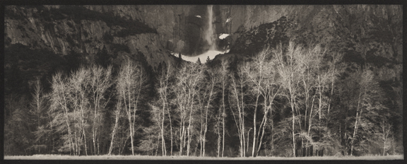

Last Valley Light, YNP, 2006
A 4x10 platinum/palladium print, taking advantage of the last sunlight on the Yosemite Valley floor. Yosemite Falls in the background.
Pentax Digital Spot readings from 5 to 13+, taken at 7++
This is the first time I have gotten rid of the bit of a notch one sees (except for rediloads) when printing sheet film full-frame. It was in the lower right hand corner and very distracting with the thin light line of grass along the bottom. I took a razor blade to the neg and scrapped off the emulsion.
Yosemite Valley
Zone VI (8x10), w/ Fuji W f/5.6 300mm
f64 at 15 seconds
Ilford FP4+ (at 125 ASA) in Ilford Universal PQ developer (1:16 at 66F for 5 min in Jobo 3005 drum)
Platinum/palladium print, Fabriano Aritico Extra White, Pot. oxalate at room temperature
none
Nicely done. I love the subtle tones, and understated contrast between the foreground trees and the background elements. And I agree with Argus, the framing really works very well.
