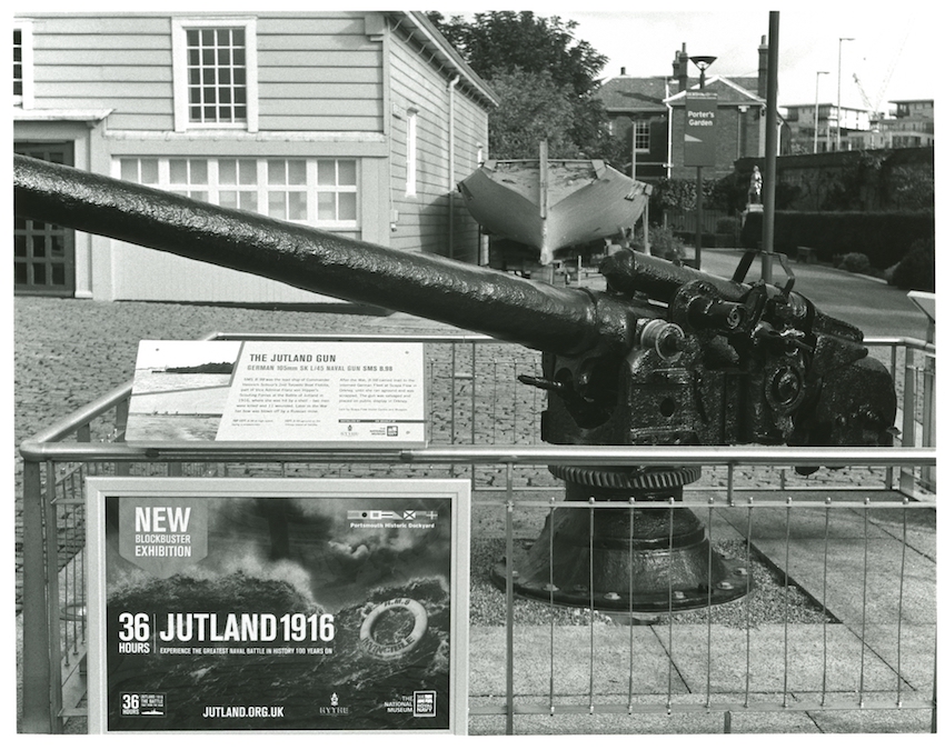

Jutland Gun
More testing after camera had an overhaul. 8"x10" print
Portsmouth Historic Dockyard, Hampshire, UK
Zeiss Ikon Super Ikonta A530 6x4.5 (made 1935)
1/250s f11
Ilford HP5+; Xtol 1:1
Ilfospeed RC graded (2); Ilford Multigrade
None
Wow - did you ever deliver the tone & texture. Beautifully done, Svenedin.
Thank you HiHo. I walk past that gun every work day. I've never once stopped to look at it......until now. The elderly Tessar works his magic.
