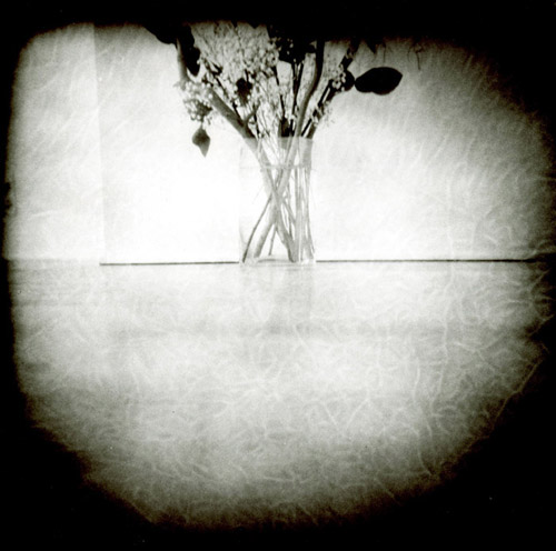

a new one from my favorite holga
new york
holga
20 seconds
HC110, 20 minute bleach
illford multigrade matt warmtone, selinium toned
none
Wonderful Michel! So many layers.
wow! How are you getting this intense vignetting? Have you manipulated your Holga to get this? I really like the look.
-david
david,
the holga has a square adapter, the vignetting comes from the long exposure. The negative is completely black after development. I then use a potassium ferric cyanide bleach. Each neg is tray bleached with no aggitation so it is almost like I am etching the silver. this allows for the interesting fog effects and the intensification of any holga type flaws. The best part of the whole thing is that these are very intuitive and so much the opposite of all the 4X5's that I have been working on for the past 10 years. these new guys are lots of fun for me. Thanks so much for all the comments.
michel
-david
Sorry to answer so late, but there is a mod where one would take out the lens and scuff/sand the edges to give more vignetting.
I too like what you do with the Holga.
