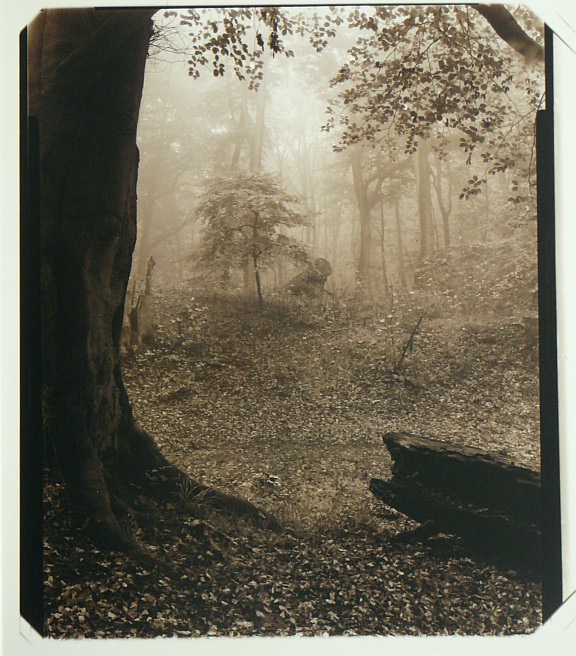

My light meter broke down in the soggy mist, so I had to guesse exposure, something I have never before done. Luckily worked out reasonably well, but I unfortunately underdeveloped the negative. However, again luck, at grade 5, I still managed to pull out this print.
Tachihara 4x5, Schneider Kreuznach Symmar-S F5.6/150mm
20 sec, F64
Ilford HP5, Kodak D76
Kentmere Finegrain Warmtone, split sepia and selenium toned
wow, marco. this is absolutely stunning!! It has so much depth, you could almost walk right into the scene! Perhaps the underexposure and grade 5 worked in your favour?

sometimes it takes a little accident, like underdevelopment in this case, to create a happy result ..... very appealing image with lots of mood and depth
Thanks all for the nice comments,
I even forgot to mention one other "accident" that happened with this image... I reversed the negative in the holder! It had the emulsion side to the back when the image was exposed... something that has never happened to me before, but of course, for everything is a first ;-). Interestingly, it seems not to have affected the image in any way. It is really sharp and not worse exposed than another image I shot at the same spot with another aperture setting. I did not use the other negative, since this one had better exposure, and better depth of field. I simply reversed the negative in the negative carrier...
