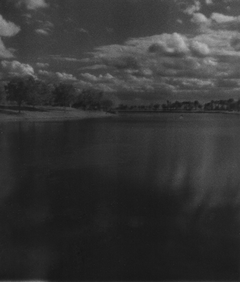

Infrared is making me crazy?
Read all about Rollei Infrared, Ilford etc etc etc....
Using a Rollei TLR with Infrarot filter.
Exposing a test shot without filter at ISO 400 and 200 respective to film.
Test shot is always black from overdevelopment times?
Negs with filter have been almost opaque until this roll---down to 40 seconds wide open under the enlarger.
Tried t-max developer, and d76--straight from developer tables---not having any trouble with regular film...
Bracketing between ISO 6, 12, 25
Is this just the life of infrared?
Florida
F22 1 sec
Ilford SFX 200/Tmax developer
Kentmere VC/FB Satin/Dektol
Infrarot

Hmm... Overdevelopment should not yield black negs - that sounds more like gross overexposure. It looks like your posted photo was taken in full sun. If your ideal film speed for SFX with filter happens to be 25, then by definition full sun would call for 1/25 at f/16. Then at f/22, your speed would be 1/12th. If you are in fact shooting at 1 second at f/22, then you are overexposing by around 3.5 stops. This could definitely give you black negs. If your TLR shutter is sluggish (as so many are), then the overexposure is even greater. If your test negs without filter were OK, but the actual negs with filter were too dense, then I would recommend a close inspection of every square millimeter of the Infrarot, especially around the edges. They can degrade over time. However, based on the excessive density of both test and actual negs, I would throttle back on exposure. (Incidentally, when you expose the test shots at ISO 200 and 400, what actual aperture and speed are you using?)
Good luck,
Jon
PS: When you say 'Test shot is always black from overdevelopment times' I am taking this to mean the negs are black. Is this correct?

I was able to determine the problem with the ilford film---I was convinced I was processing it incorrectly. It was my TLR from 1932 that was the problem. Close inspection revealed the shutter was not allowing the blades to shut completley. IE F16 would leave a F22 opening after exposure and F22 leaving an F64? opening after exposure...almost effectively solarorizing my infrared film. It is a new problem that started with when I put my first roll of rollei(9 rolls ago) embarassing!! and I chaulked it up as learning curve rather than equipment failure
