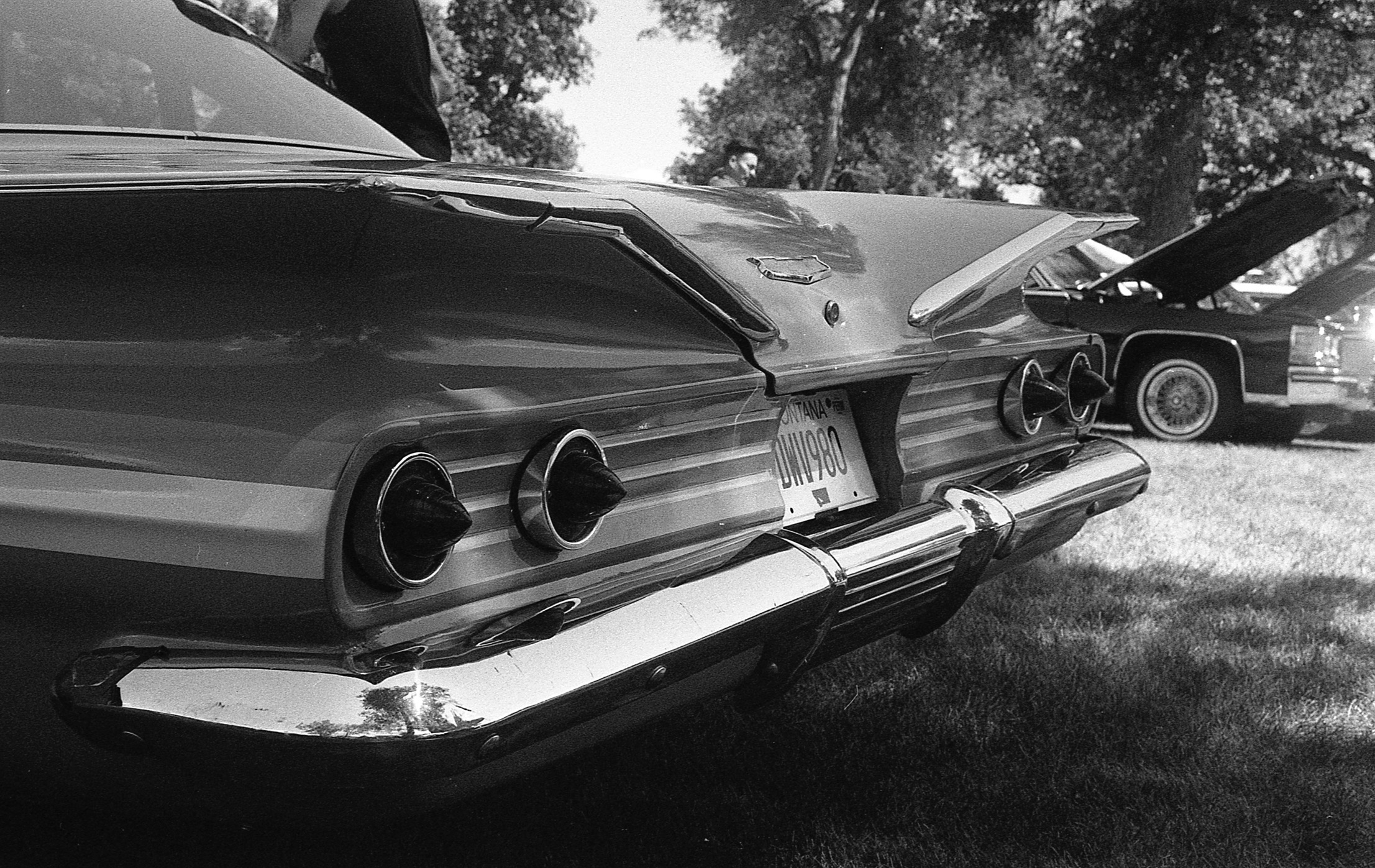

I was testing out a new to me Minolta X-570 with some Ilford FP4+ and, like a noob, I forget to set the ISO and found that it was at 800 when most of the roll was shot. Took care of that in development.
Rollerz car show, Billings, MT
Minolta X-570, 35-70 zoom
FP4+ @ 800 ISO, Rodinal 1+100, 2 hour stand, agitate at 40 and 120 minutes, room temperature
Hybrid Materials & Processing
Scan of the negative
Vince, do you mind me asking how much Rodinal did you use? It's a 35mm camera, isn't it? How much was the total developer solution? The sources I've read about Rodinal recommend a minimum amount of 5 ml, so I was just curious.
I used 2.5 ml Rodinol and 250 ml water. I though about it getting exhausted and considered making a 500 ml batch but the roll was sacrificial so….
