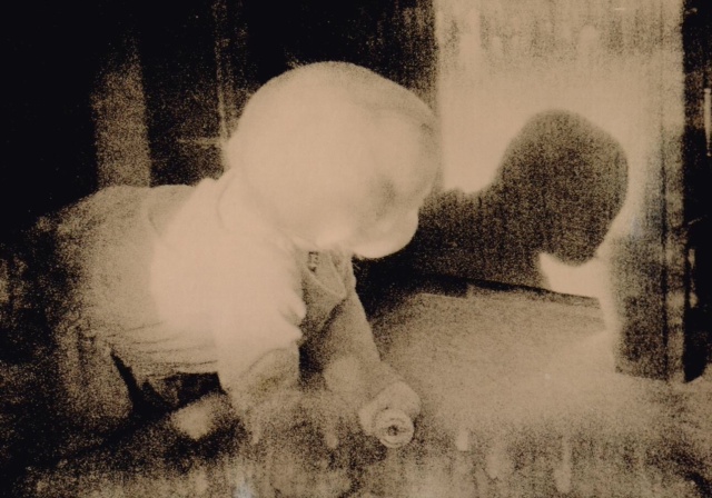

I'm getting these art nouveau edge effects on my lithed Fomabrom paper. Works OK with this image, but I'd like to be in control of it. First couple of sheets through don't seem to have it, then increases with each sheet after. By the time I'm at 8 or so it's covering most of the sheet. Any thoughts?

Fomabrom, Arista lith
I like the image, looks like the baby's first encounter with its own shadow. You have better control of lith than I have, so can,t help with that.
The first sheets in are very seldom any good (the only paper that worked out was the Kentona) and then you have the sweet spot which tapers off when the developer exhausts. I don't know about the edge effects you mention, could be a manufacturing issue (lith shows any QC issues very easily) or possibly, an agitation thing.
