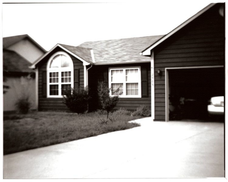

Got my Seneca 8x10 up and running! Made a singlet landscape lens (400mm) with a bit of glass, some PVC, rubber washers, latex calk, glue and paint!
My House
Seneca 8x10 w/ home made 400mm f/10 singlet
2 seconds
Arisa Edu.Ultra RC paper in Dektol
Arista Edu.Ultra RC paper in Dektol
2 stop ND behind lens
This is great. Would love to see you combine this with your salted paper work. You're right there with WH Fox Talbot.
Very interesting - is this lens a simple crown element or is it an achromatic lens? If it's a simple crown element, it would be interesting to try it with a strong filter to reduce chromatic aberration.
Used uncoated plano-convex lens, 40mm diameter with 400mm FL. Least expensive one from Edmund Optics that I thought would do the job (just in case I screwed it up).
I still need to make stops for it, and I have a plan that involves adhesive backed magnets and tin!
