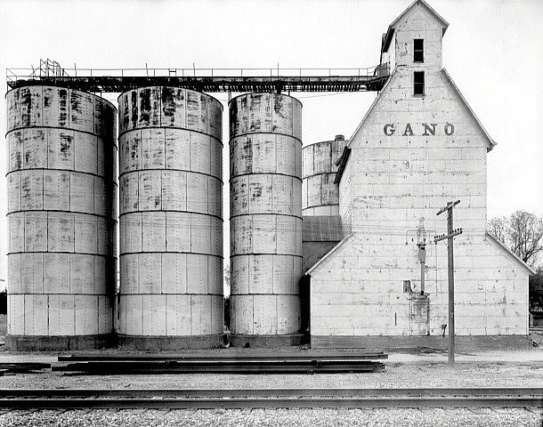

Homage to Wright Morris
This is printed version, not a negative scan.
Western Kansas
8x10 Deardorff, 12 inch Commercial Ektar lens
f/32, 1/25 second
J&C Classic 400, Pyrocat HD 2:2:100
Kodak Azo Grade 3, Agfa Neutol WA
none
\"Not a negative scan\". I love it!!!! Negative scans are always suspect IMO.
Alex, do you find, as I do, that Classic 400 cannot build enough contrast to work with new G2?
Such a dynamic and well balanced composition. Bravo!
Thanks Francesco.
I have a mixed feeling with J&C 400 and Grade 2. It seems to hover on the border line between grade 3 and grade 2. My other post tonight was done on grade 2. As I was printing these I thought next time, I will give it one more stop of exposure; effectively shooting it at 200 vice 400.
I still like the tonality of grade 3, so I prefer to use it all I can.
Hi Alex, I just picked up the book "Photographs & Words by Wright Morris. A friend from photo.net suggested I give it a look. It reminded me of your pictures so I thought I'd look for you to see how your large format is working out. Looking Good!
Anyhow, this building is in that book. Being from Kansas I'm sure you're aware of that. It looks as though a few things were added since the Morris days. Neverthe less, still an interesting subject & you treat it well. This site is way better suited for you, as there's not all the PS manipulation. I've been surfing this site & generally like what I see. Keep up the good work. [By the way. This is Mike Marcotte. from pnet]
Much cleaner than the negative scan. Nice, Alex.
Bernd & Hilla Becher move over :smile:
really love this one alex, if the scan looks this good, i can only imagine how your print must sing --- keep up the great work!
Mike, glad to see you show up here on APUG. Hope you hang around and start posting too. Really like that name you chose; goes with the territory doesn't it.
Thanks for the comparison Ralph. Glad you got to see the print and glad you like it.
John, the Bechers are favorites of mine. I got to see one of their works last year first hand. Thanks very much.
Alex,
Nice composition.
I have a question. On my screen I'm seeing detail in the rail straight ahead and then as it goes to the left it gets very dark. Same thing is happening on the pile of rail. Even the gravel appears to gain in density as it goes to the left. IS this something from the scan? or is it in the negative/print? Or am I completely in left field on this on and I'll just chalt it up to my monitor.
George
Thanks George.
The far sides are slightly darker than in the middle, but on the print, there is still texture and detail. If you look on the far right background, you can make out the back side of a privy (yep, there's still a few in use). On the print, some texture is discernable but on the print, it looks shadowed. My scanner seem to accentuate these changes. I'll never by an HP scanner again.
