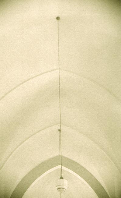

From a recent outing, was using a old brass RR lens that had been front mounted on Ilex No.4. Turns out it works great on 5x7, but on the 8x10 it lost a great deal of coverage. Decided to print the 8x10 negative anyhow and with little maksing came up with this one...I like it, curious what others think.
New Corn Hill, TX
Korona 8x10, brass RR lens (about 300mm)
14min f/44
Efke PL100; Pyrocat 2.5+2+100
Lithium Palladium on FAEW
Mike, this is absolutely lovely!
well done mike. It works wonderfully masked and cropped. wonderful serendipity.
Thanks for the kind words guys. Serendiptiy indeed Matt, have to admit was disappointed when I first pulled this one after developing, but as you know found a way to "find" something I really like.
Personally - I find the cropping a little tight. I would like to see what you would have seen had you backed up a little bit.
