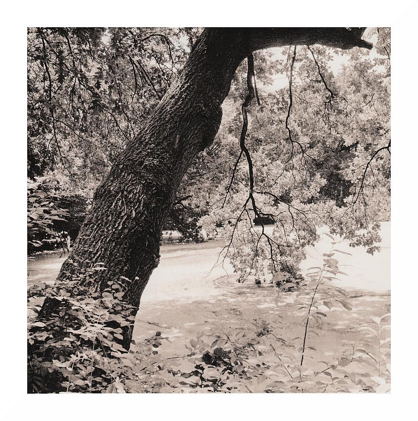

Stadtwald, Bremen.
Rolleicord Va
Fuji Acros 100 & Rodinal 1+50
Forte Polygrade & SE5 Lith
Light-Green Filter
Hmmm, technically and photographically it's a great shot and nicely done. My problem is the lith and on this particular print the water seems milky and it gives it a sort of unpleasant look. Perhaps sometimes some various "treatments" we give out work doesn't really work out.
Pond was completely covered by light green algae. I should have exposed one shot without light-green filter and other without direct sun light.It was the day after big storm so it was clean and brilliant. A shot without light-green filter would have rendered the leaves little darker hence not much of separation. A shot without direct sun light may have helped a bit but brilliance of the bark lit by subtle light must have been lost. Other way is to print it differently to get more colour on hight-lights. I was little impatient so I have chosen slightly higher concentration to shorten the development time.
