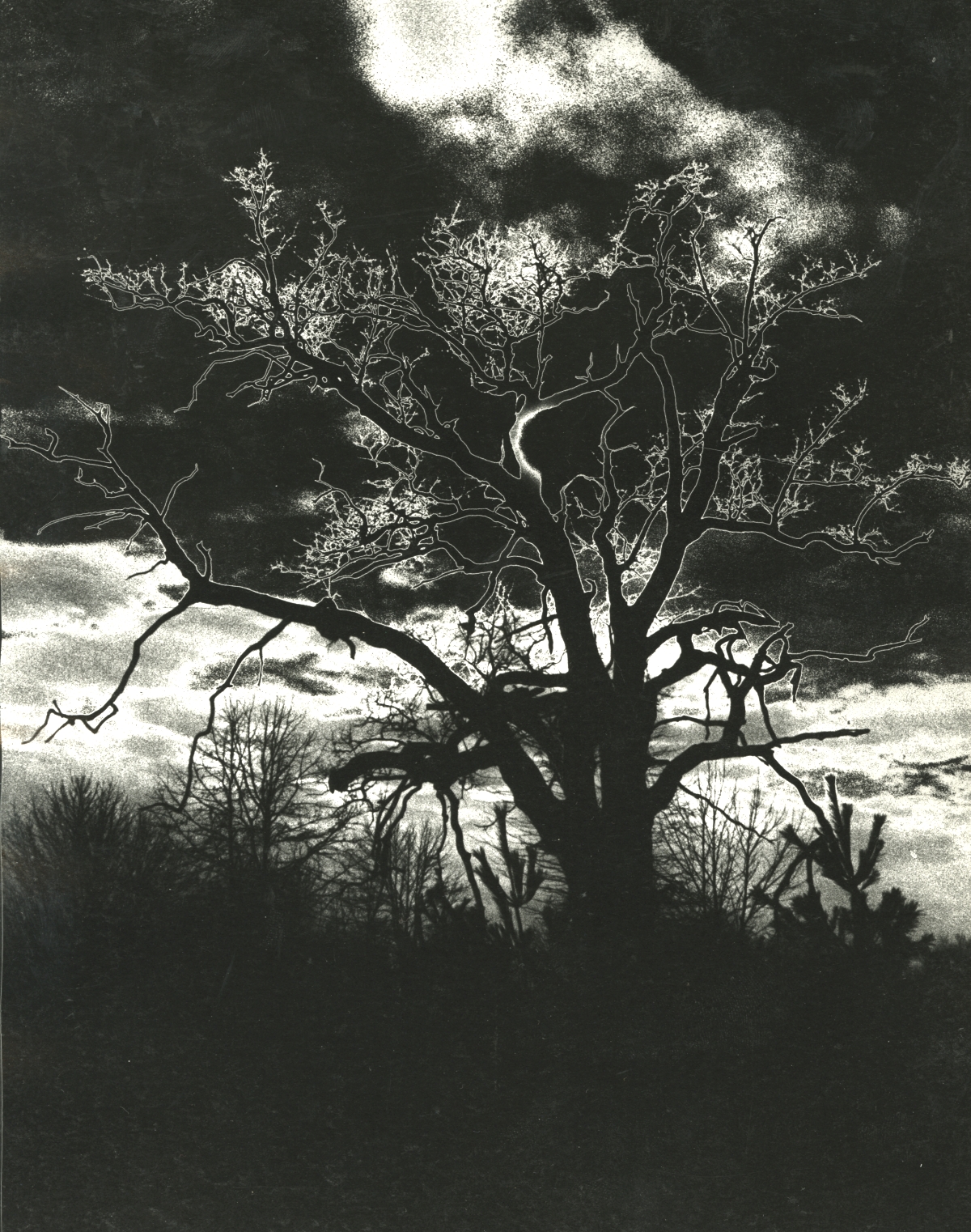

This is an image I did in about 1974 when I was trying to get control of the Sabattier process.
Original image shot at Ft. Dix, New Jersey.
Minolta SRT-100, 50mm
Kodak Tri-X, Microdol-X stock, 10 minutes at 68 degrees
Agfa Brovira #6, Dektol
Hybrid Materials & Processing
The print was flashed with light halfway during the development. This is a scan of the 8x10 print.
In the sky above the middle of the tree there is a ghostly slightly evil face looking directly down at it It suits the slightly other-worldly sabattier look
