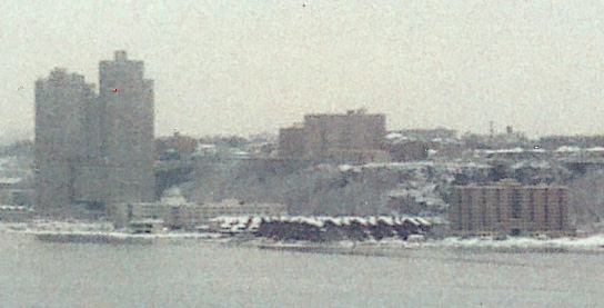

The first test of my new 8x10" Polaroid setup purchased here on APUG from Gustavo Castilla.
What I learned--
There are only 3 films available--803 (800 speed B&W), 804 (100 speed B&W), and 809 (Color), and they all cost about the same price.
Type 809 really is for strobes and starts to show a reciprocity shift toward blue/cyan even at 1/30 sec. I used a 1A filter to counteract the blue from the overcast sky, but probably should have used an 81A or B.
The frame is a bit smaller than 8x10", otherwise I wouldn't have clipped that oval on the right.
That said, big Polaroids are really neat. At about 9 bucks a sheet I'll be exposing it verrrrrry carefully. I'll probably shoot mainly color, because color Polaroid has a distinctive look.

Gowland 8x10 Pocket View, 10 inch WF Ektar
1/25 sec., f:16
Polaroid 809
1A
That is from your apartment window right? Hell of a view, and nice shot of it. Forgive my colorblindness but is that really in color? Makes a hell of a BW. No PS needed for desaturation my desaturation is natural.
Ahhh...Columbia owns the entire upper West Side by the river...LUCKY YOU!! Actually, it's a very nice shot..the oval, a brilliant appendage to Grant's Tomb and Riverside Church. Color will be welcome here with all the opportunities you'll have for late evening light.
Great shot...love the mono-tone look of color prints like this, and the sharpness - well like I said Great shot. Yeah, the price per sheet is what keeps me from trying 8x10 polaroid transfers..but still want to.
Thanks, guys. I am indeed lucky always to have an interesting cityscape from my window. We could use a few more square feet inside the apartment, but it's hard to beat the view.
I should offer to team up with dagor77 one day. He used to post a test shot of this parking lot, which I'm guessing was behind his apartment, with every lens he sold on eBay, and I guess when his reputation became more secure and he started selling more lenses he stopped doing that. It was actually a really interesting way to compare lenses, because it was always the same parking lot, but unfortunate that it wasn't a more attractive view.
There wasn't much color in this winter scene, but there would have been more with better filtration or if I'd waited for better light, but I just wanted to test the processor. It wasn't that hard to use, having gone through the process, but the instruction manual with its sequence of 31 illustrations (read: "31 opportunities to ruin a $9 sheet of film") was a bit intimidating.
I'll definitely be doing some portraits with this.
Type 809 isn't that sharp compared to film. Polaroid rates it at about 9 lpm, compared to 20 lpm for type 804, and even a grainy film is usually more than that. 9 lpm is enough for a final Polaroid print, but I wouldn't be inclined to dupe and enlarge it.
$9 very well spent..any photo that includes ME is worth at least that much (we're just in front of that cluster of tall buildings at 1 o'clock ). I LOVE the colors. This reminds me of old tinted postcards of the area before the West Side Hwy ruined the walk down to the shoreline. Progress.
I thought I recognized you there--
Great shot, David. When i fist saw it i thought it was hand-colored B&W...
