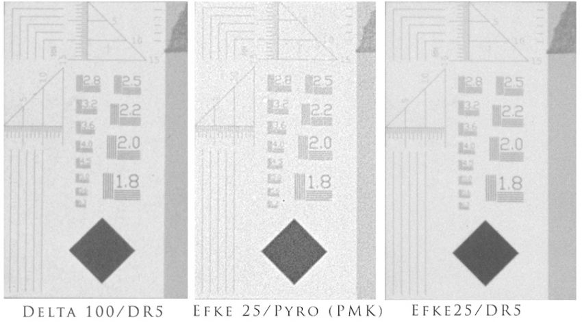

We have had several inquires for the differences between dr5 and negative development. Richard Lohmann http://www.richardlohmann.com one of our regular clients performed this test. Since APUG folks are such fans of PYRO I thought I would show this test.

The grain appears to be much finer and smoother with the EFKE 25/DR5 than the EFKE 25/ PYRO (PMK). The sharpness also looks good. The acuity seems to be a little bit crisper with the PMK though, albeit at the expense of coarser grain which is often the case for most high-acutance developers.
