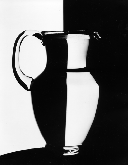

glass #3
glass #3
8x10
tri-x d76
Polymax FA
I normally don't go for this kind of effect but I really like this one. Very well done.
Erwin,
The set up for this is petty simple. The pitcher is on the back of a stool, which is covered in black felt. A few feet behind the pitcher I have a black felt background. The white background is a peice of board painted glossy white. I put the white board in front of the black background and lined up the pitcher so that it was split evenly by the two backgrounds. The white backgound is lit with 2 studio strobes located to each side of the stool, each with barndoors to keep any light off of the pitcher.
Great shot. Thanks for the details of the process.
