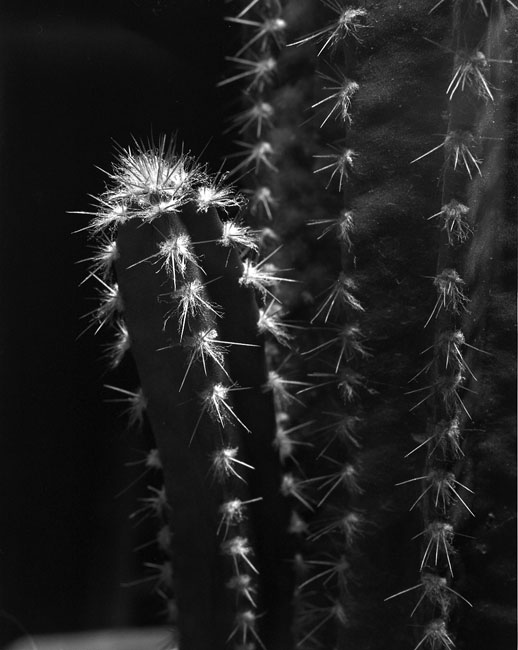

Playing with 4x5 macro, I tried out a potted cactus under the White Lightning unit. First try at metering with the Minolta ambient flash meter resulted in an error message, the flash was too darn bright! So I grabbed my spotmeter and used a grey card and finally got a reading of f/90, which by my calculations led to setting the lens at 22.5. Using the 65mm had the camera about three inches from the cactus which made it a bit interesting focusing using about 200mm of bellows draw and about 1.5 times life size image. Image still looked a bit soft under the loupe when I examined the neg on the light table. I'm wondering what else I could do to get a sharper image on the film using this combo. Or perhaps my 150 will do better for image size with more bellows draw? Curious to know others experience with a similar setup.
my basement
Cambo 45NX, 65mm
flash, F22.5
Tri-X in Pyrocat HD
Film scan
When shooting that close, it's hard to focus. Get focus close, and fine tune by moving tripod in and out to achive critical focus.
Thanks vet. I did manage to get the focus where wanted it but it seemed the critical sharpness was lacking where it was in focus. I don't know if it was diffraction or some abberation in the light path in the lens causing that.
I've had similar issues with focus on a 90mm up close. Have to look at the ground glass very carefully with a good 4-6X magnifier. Found that the satin snow ground glass really helped in these situations as the surface grain is smaller and critical focus is easier to see. Do a search on APUG for the source - he's a member of APUG. Another resource I use is a Kodak Professional Photoguide - approximately 5 X 7 inches. It has dials for lens depth of field and exposure correction. Also a section on view camera basics. This resides with my view camera.
