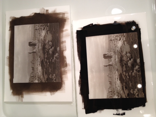

This is a platinotype example of the use of Fumed Silica. I posted this in the alt forum here but wanted a more generally accessible example as well.
The image on the left was a normal pt processed print, the image on the right was enhanced (imo) by brushing on fumed silica to the paper before applying the metals emulsion.
Rob's Darkroom
Foam brush, fumed silica, actinic light
4 minutes. YMWV
Potassium oxalate.
Looks like a similar effect to pre-flashing regular silver gelatin paper. The general contrast is lowered quite a bit. How's the local contrast?

Don't know about mica, but we have been using other things like Magnesium something or the other for thickening inks for bromoil for some time. I have a bit of that, might give that a try too.
FS may be working due to it's huge surface area. I keep thinking it's like super coating but that doesn't explain the boost in contrast.

I think you're on to something with your surface area comment, Robert. Offhand I'd say you get a boost in contrast when you have more surface area per viewing area. And small particles have very high surface area. And the particles you put on have *very* high surface area, I would say. The way I think of it, this effect is kind of similar to what you get from double coating/exposing, which is of course a PITA. The mica powder was given to me by a luthier who plays with all manner of backyard potions to try to improve the look and performance of wood coatings. It looks like fine white powder but it has a certain shimmer.... I just worry about it flaking off, that's all. But your stuff has jagged, kind of fractal edges so I guess it has very good binding.
This just goes to show that the old processes can still be improved after all of this time.
Well done.
On my monitor here it seems you have an enhanced D-Max. That would make a deeper print with more apparent contrast. I'm also wondering if the fumed silica keeps the image more on the surface. That too might make for less of the light striking the image being scattered when viewed. Must try it. I assume you got the materials from B&S? Thanks for posting.
