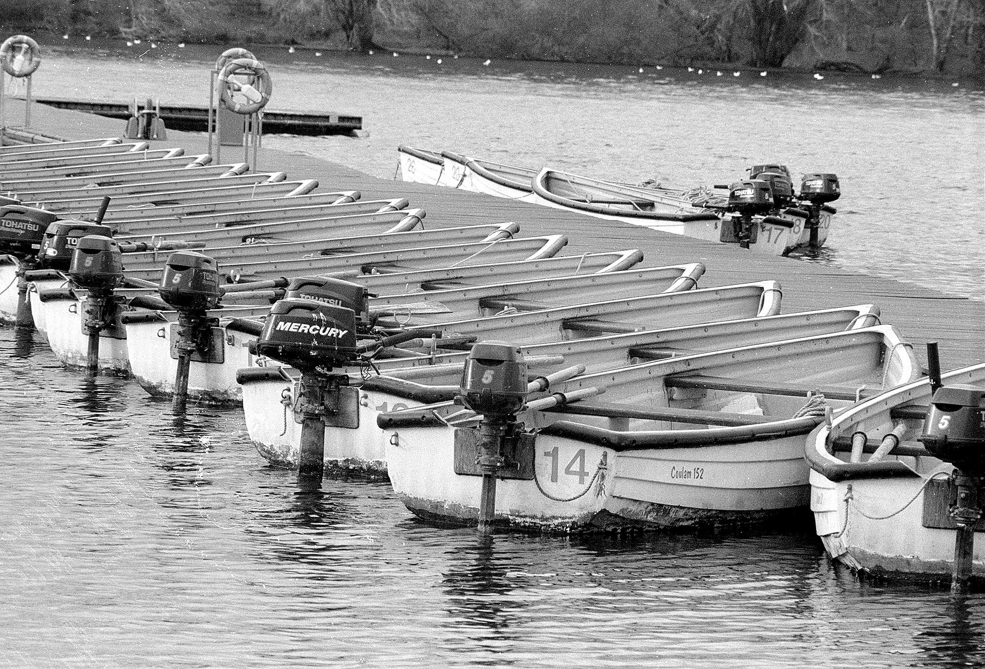

Trying Crawley's FX-55 formula again with double the 1% PHENIDONE and a little extra Sodium Ascorbate -- result was still -UNDER-Development at recommended time of 8.5 mins @ 20oC OK for 'SCANS' but not enough 'Meat' for Darkroom Prints.
Hanningfield Reservoir, Essex ENGLND
CANON FTbn + 200mm f4 SSC Canon lens + Tripod
1/30th @ f11
2010 dated ILFORD FP4 + in Home-Made FX-55 8.5 mins @ 20oC
NG SCAN
ORANGE
SCANNER : PlusTek OpticFilm 7200 + Vuescan Pro + FastStone Image Viewer
yes -- amazed how it 'scanned' but it is still too 'Soft' for me to do darkroom Printing. I have the other half of the Film loaded for further 'Experimentation'
