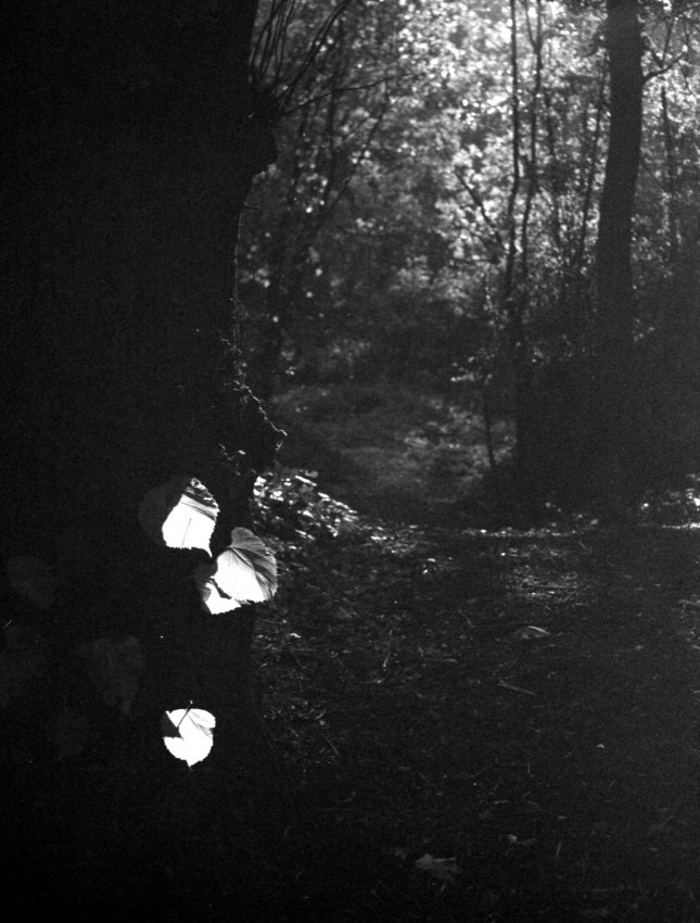

A very high 'Subject Brightness Range' but I thought it looked 'Artistic' ----

1962 ROLLEICORD Vb + 16-on kit
1/500 @ f9
outdated ILFOD Delta 400 Pro in home-made MICROPHEN 1+1 for 9 mins @ 20oC
Neg Scan

I am going to hurt your feelings and say that this does not quite 'make it'. The gross underexposure of shadows, combined with the correct exposure for sunlit sections is too extreme to be anything close to aesthetic. Your exposure of EV 15.5 is a bit difficult to assess because one does not know what speed the '400' has devolved to by now with it being so old. (Fast films get slower faster than slow films do.) An attempt to highlight those three or four leaves by the 'golden sunlight' fails because there is little but glare there.
Pentax Pete: please do not consider this post to be an attack, but, rather, a viewpoint that is simply meant to force you to reconsider. I have had pictures that were far worse; thus, I am not entitled to rate your work in other than a solitary evaluation which hinges upon no prominence, evolves from no provenance.
To salvage the extreme lighting situation I probably would have exposed at about EV 13.5 and developed the negative about 20% less. - David Lyga
David -- NO PROBS at all !! After over 60 years in Camera Clubs I am used to 'Critiques' !! I guessed it would be 'technically difficult' and the 'Misty' one was next frame so could not do an 'Ansel' and process differently.
It just fails, Pete, because there is nothing there, nothing to think about other than what is missing. - David Lyga
It's what we call in Camera Clubs a 'Judge Bait' photo --- Ha Ha !! Thanks all .
