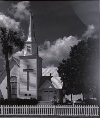

flair or not
michael9793
flair or not
Print #2 is the 300mm Wollensak lens with the filter behind the lens
This one's definitely not flare, because it's on the wrong side with respect to the light.
The flaw on the right side in the middle looks like a light leak.
The flaw in the upper right hand corner, and the other ones, look like a development issue, as if the film hadn't gone into the developer evenly or got partially wet before going into the developer, but I couldn't guarantee that.
What a beautiful image! (more's the pity for the light on the right!).
- Bert
David
I agree the light on the right side looks like I didn't have the plate seated. I usually keep the Darkcloth over the back after removing the slide, but I didn't this time. Another thing that I did differently. Hummmmm
