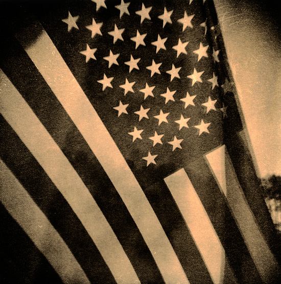

part of a small Holga/lith project ... translucent flag ...
home , Florida
Holga 120N
Adox 100chs art , pyrocat-mc
Forte Fortezo , LD20 lith, sel.
thanks David and Kal .... David this print is approx. 7x7 inches as are the others posted. I have gotten in a habit of making a smaller print first ( to post here) and living with it for a week or so mounted and framed. Then by request or predetermination I go up in size. K. , Fortezo is my new love in lithable paper though it is getting scarce fast. I over expose 3 stops and then develop this in LD20 60ml A +60ml B + 60ml "old brown" + 2000ml H20 @ 75 F . Snatch times were around 8.5 to 9.5 minutes. Kodak stop for 1min and Ilford Hypam fix for 2 mins , wash 5mins., PermaWash bath for 5 mins, wash for 10 mins. Kodak selenium 1:9(mixed with PermaWash) for 3 mins. This paper changes fast in selenium at that dilution. If you just want Dmax and a little contrast boost 1 min will do. Any more than 3 mins red brown takes over ! The max colors came with the 3rd through 8th print . At that point a shot of 10ml A +10ml B was used to finish the session. Hope I this helps, K. :smile:

Excellent Miles. Thanks for the info. I have found Selenium "kills" lith with my Rollei Vintage/Goatone 132...maybe I leave it too long or it's the paper. Will play the next time I Lith! Rgds, K
