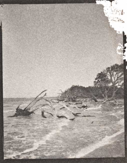

My first successful effort using the satista process.Coated on Strathmore Aquarius paper. The paper texture seemed to give it a very grainy look and some of the black washed off during the rinse.
Jekyll Island
4x5 Anba
n/r
Ektapan/Rodinal
satista/strathmore aquarius
Interesting, the paper texture gives a very interesting look to this. If you are not looking for the texture for grain though, would recommend some Cranes Card Stock (also known as Platinotype) or some COT320...depends on how much you like the texture. Would guess the reason it washed off, is the substrate is sitting on top of the paper, rather than going into it very much...but you probably know that already.
