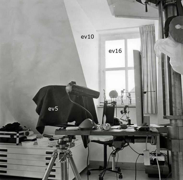

I developed a rollfilm with pyrocat HD as a 2 bath. 1:20 5minutes in A and 10 minutes in B. This is the result.
Light values measured are entered in EV
2 bath
Thats really neat Willie Jan,I have close to the same situation as you have in your photograph here. I was thinking of using a high dilution of hc110 1:100 or more but have my doubt's ,have heard that pryo works good for this kind of development. Now that I see your photograph I think I'll give pryo a try,it has worked very good on your photo. Thanks for the example.
