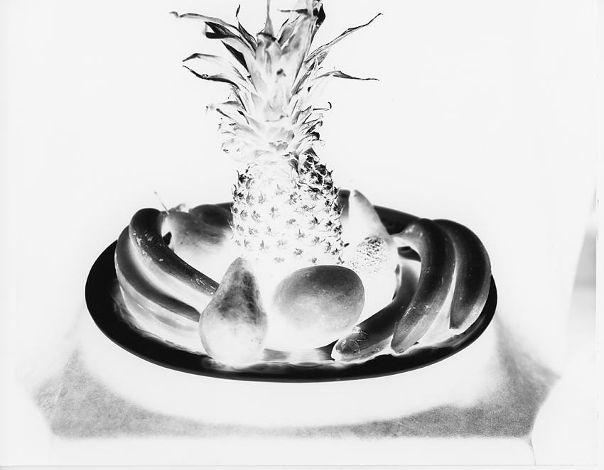

I'm excited at not only my first chance to use my refurbished 8x10, but also about my first stab at paper negative processing and
contact printing. Taken with a Seneca/National 8x10 with Betax No.4 Wollensak Shutter, Kodak Polycontrast III RC Semi-Matt paper rated at ASA 4, f11, 35 seconds, developed Dektol 1:2. Contact printed on Ilford Multigrade RC Glossy paper. This
is a great alternative process to using film and I have thousands of sheets of paper to play with, so let the games
begin.
Seneca/National 8x10, Betax No.4 Wollensak Shutter
f11, 35 secs
Kodak Polycontrast III RC, Dektol 1:2
Ilford Multigrade RC Glossy, Dektol 1:2
