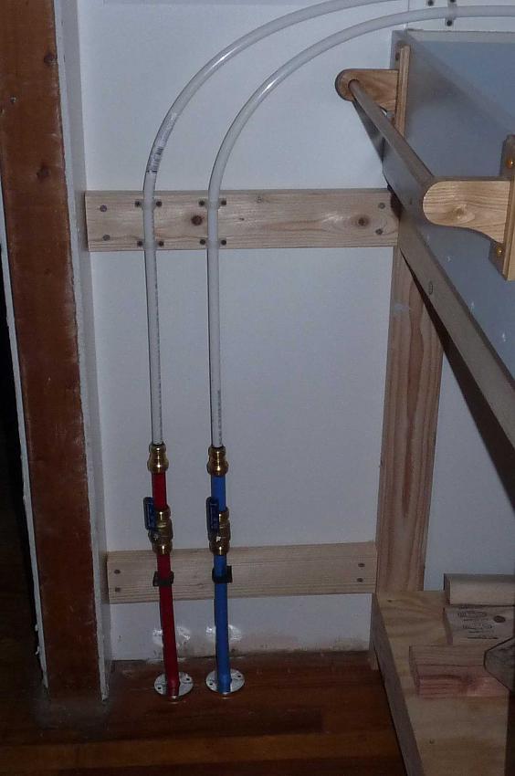

Finally done with the plumbing. I had to shorten the hot/cold supply lines, they were way too long. The supply lines are 3/4 inch Pex, the ball valves are the Gator Bite brand from Lowes. You see the 4 inch Pex extensions above the valves, then a 3/4" to 1/2" Gator Bite reducer coupling. Finally, 1/2" Pex supply lines for the faucet.
