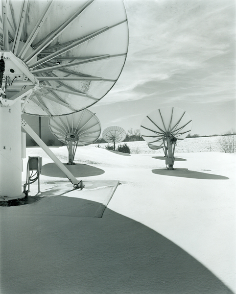

Same neg as previously...from the new darkrooms first fiber based printing session utilizing a new workflow:
2 min Zone VI developer 1:3
1 min water bath
2 min TF4 fix
2 min TF4 fix
4 min KRST 1:12
Topeka, KS
Zone VI 4x5/Schneider 150mm APO Symmar
F45/1sec/#25 red filter
Ilford FP4+/510-Pyro 1:500
Ilford MGIV FB/Zone VI 1:3
split-grade
yep and looking pretty good....I like the tension between the shadow shapes and abundance of highlight. Miles
Great image. Very clean tones. Thanks for showing the one you had at the guild meeting! Do you prefer it on fiber?
Cheers,
Joe
Yes, I do, Joe.
I think this print needs more hard exposure. I had to work the curves in photoshop just a little to try and match the scan to the print a bit better than the raw scan. I'm afraid I may have overshot it a little because the print's still a bit flatter than this. My scanner isn't very good and it seems to be struggling with this paper more than it did the RC.
