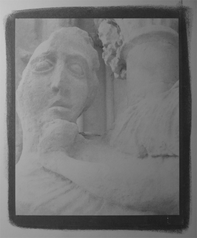

Finally pulled off a decent 8x10 Gum Bichromate print on gelatine sized, Arches Platine paper. Gelatin size was hardened using 5% ammonium dichromate, then zapped in UV exposure unit.
Exeter cathedral, Exeter, UK.
Linhof Tech IV
Hp5; Xtol 1+1
Gelatin sized Arches Platine; tepid water
Hybrid Materials & Processing
Digi neg on OHP material
Cropped

Nice work Andrew.
I like Gum Bichromate print, but I havent looked much into the process. This looks to be lacking in depth, maybe a darker back ground to get the statue to stand out a little more. Probably the way you intended and still way better than I will ever do.
