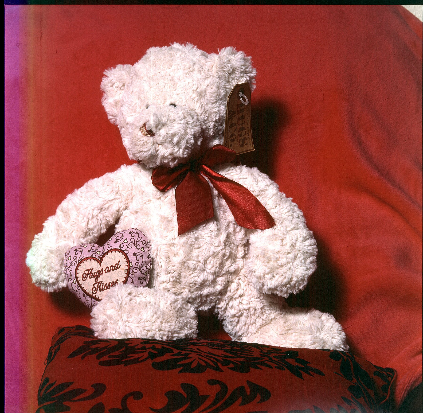

E6 Process Test 01
Given a load of Jessops E6 Slide process kits I tested the Chemicals. The Colour Developer Part 2 was completely Dark Purple and useless. There was some 'Formalin' Stabiliser -- a Carcenogen !I tried using the 1st Developer, my USED C41 Colour Dev and Kit Blix
BRENTWOOD Essex ENGLAND
Mamiya C220 + 'Blue Dot' 135mm f4.5 Sekors Bowens MONOLITE 400 E flash
flash + f22
1992 dated FUJI VELVIA 50 in E6 1st dev but C41 Colour Dev
slide Scan
NONE
SCANNER : CANON 9000F Mk II + Vuescan Pro + FastStone IMage Viewer to adjust colours
Pete this looks like the same teddy bear as in the scan of the b&w print. If it is I am surprised at how dark the teddy's bow appears in b&w. Usually a red-gold colour is rendered quite light in colour in b&w
Thanks
Thanks Pete. I am wondering if it is possible that your Neopan 400 could be responsible for turning the red ribbon on the teddy into what looks to be black. It may lack some red sensitivity but I didn't think as much as seems to be the case here. It almost seems ortho in its colour response
