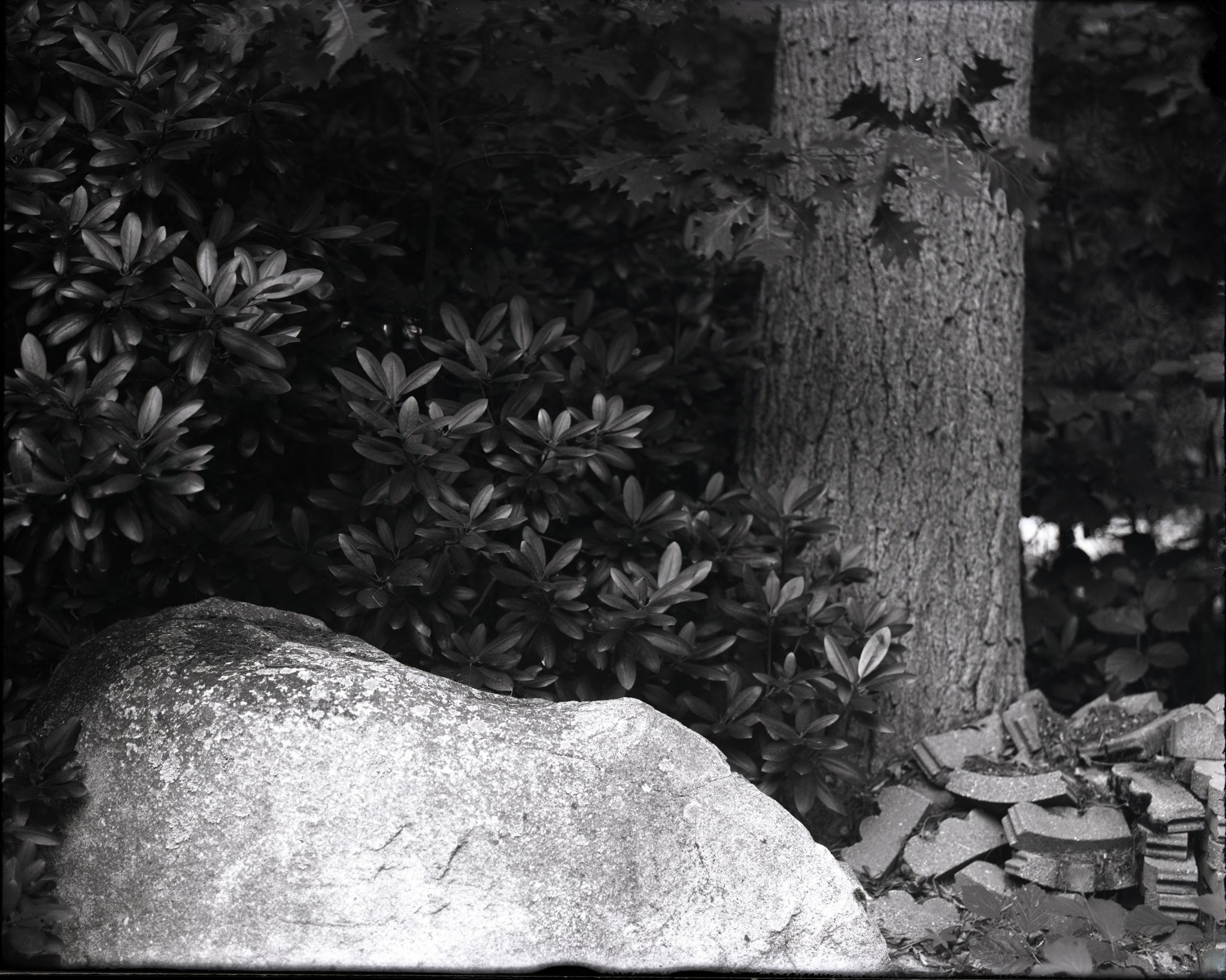

New emulsion, with improvements to speed and contrast.
At the house
Graflex Speed Graphic
J. Lane Dry Plate, latest batch
It looks like Dry Plate doesn't give the same tone scale as it is on silver print. Or am I wrong? But it is worth to try and get experience.
It is nice you start to evoke the interest among the people here. Thanks for your sharing..
@Afselius
This is a scan of the glass negative. These old emulsions are typically high contrast but based on the characteristic curve data I generated, this batch is not so bad. When I make prints I typically need to print to grade 0 or 1. This might actually print to a 1 or 2.
It’s also unsensitized so it only sees UV and blue.
Nice! I'm hoping to get out in the next week to shoot some plates. I actually have a plate waiting to be developed (if it hasn't melted in this heat) that is of a similar scene to this one. Just waiting to get some hardening fixer before I do.
