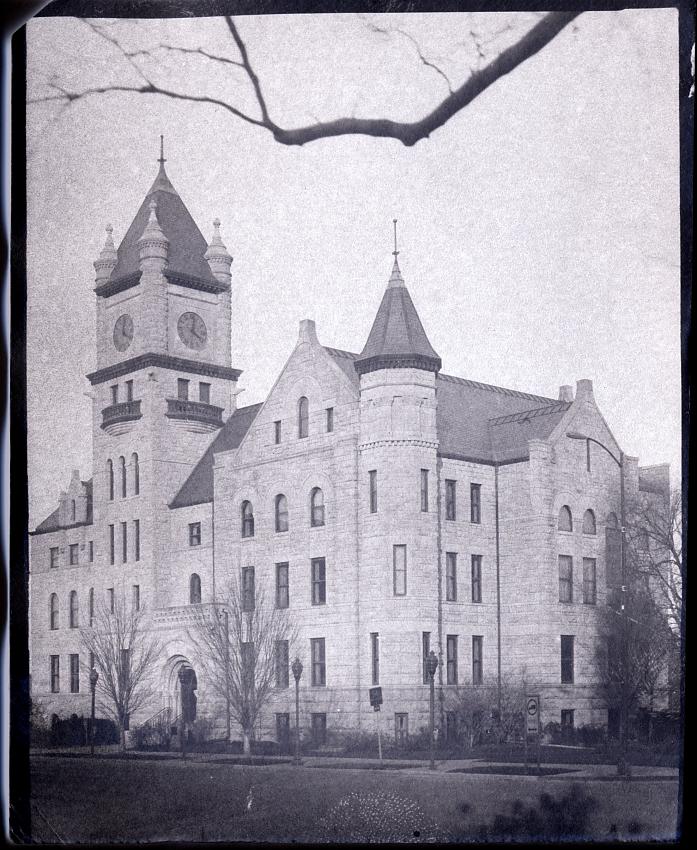

Douglas County Courthouse, KS - AZO in Camera - Paper Neg
holmburgers
The Douglas County Courthouse in Lawrence, KS. Architect John G. Haskell.
I'm thinking to call this emulsion PE-AZO (pronounced peezo) or Mowrey AZO. Either way, this is what Ron will teach to you make if you take a workshop with him and Mark at GEH.
Shot outside on a bright sunny afternoon for 1 minute at f/32.
Paper neg, flipped.
[url]http://www.apug.org/forums/forum205/101959-mowreys-azo-camera.html[/url]
Lawrence, KS
B&J Press, Burke & James Press w/ 180mm S.K. Symmar Convertible
f/32, 60"
AZO Chloride Emulsion Liquidol
Strathmore Bristol
NONE
Thanks everybody!, 'means a lot.
Brett, the texture is a result of the paper and specifically this unsubbed stuff, the emulsion has soaked into the fibers.
I wonder how well the negative prints "back onto itself"... if you know what I mean... taking a negative with the emulsion, and then using that negative to make a print on the same emulsion.
Nice. Take out the mercury vapor light and the no parking sign and you'd think it was done in the 1860s.
