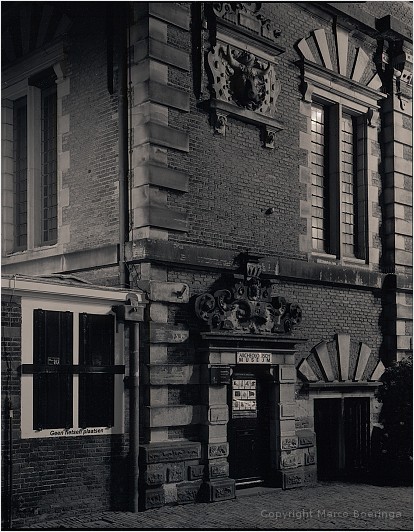

De Vleeshal, Haarlem, the Netherlands
17th century meat market designed by municipal architect Lieven de Key in Renaissance style.
Still a test print in the form of a contact. I will probably burn in the top left part a little with a high grade filter to get the tones balanced out in the final print.
Tachihara 4x5, Schneider-Kreuznach Symmar-S 5.6/150
F22, 2 minutes
Ilford HP5+, D76 1:1 7 min
Contact print for now, Ilford MGIV RC deluxe, sepia and selenium toned

Thanks Shawn, actually, this is a little detour from my normal night work in Haarlem. The large series I have been showing up to now were all on 35mm film, but I decided to do a couple of new images on 4x5, not really intended as part of the series, just nice to do and hopefully print very large sometime soon.
