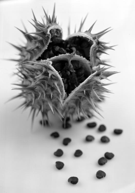

Seed pod of the datura plant.
Backyard, Virginia
Rittreck 5x7, 5x7 back, Mamiya RZ 110/2.8, hand shuttered, tungsten soft boxes
f/22 and 1 sec or so
Efke 25 PL, Ilford ID11 1+1, 8 mins @ RT
scan for now
none

Could you explain about the 5x7 back? Would this technique work on and RB?
Well, I just put the RZ lens on a lensboard for a 5x7 camera, and I shot to 5x7 film usign a normal 5x7 film holder. I glued together a body cap and a rear lens cap, drilled out the middle, and the resulting object fastens the lens to the lensboard. At macro focus, say 1:1 and up, the lens covers 5x7. This particular lens is definitely not a great performer at macro range in terms of rectilinearity and corner sharpness and res and so forth, there are much better ones in the rb/rz lineup if you wanted those things, but I picked this lens for its soft character. At 1:1 and up, there is plenty of image circle for substantial tilts, as you see here. This was ~2:1 macro so the image circle was ample.
The nicest thing about working with a 2.8 lens on 5x7 is that the ground glass is *bright* even at macro magnifications. So you can work out the critical tilts etc. wide open and then stop down as much as you wish. In this case I took shots at several different apertures and just settled on this one because there is a balance of softness and sharpness that I think emphasizes the spikes. When I stopped down more the subject became to two-dimensional IMHO.
P.S. The tilt/shift adapter for the rz (or the hassie) is way, way more limited than what you can do with a simple view camera rig.
