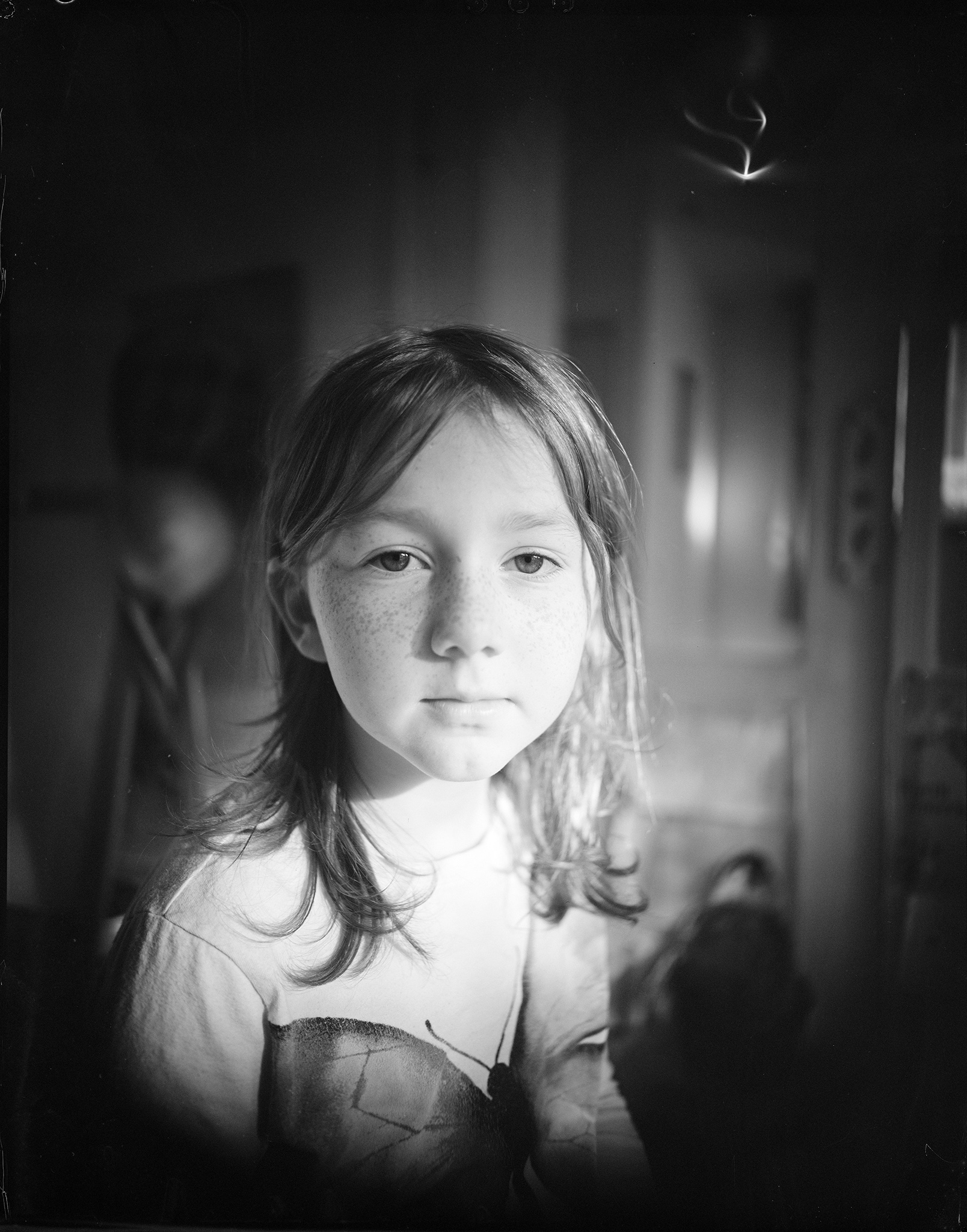

135mm / 8x10 / something doesn't add up
Kodak 135mm f/7.7 anistigmat
Fomapan 400 | Rodinal 1:15 (Rotary) 10'
The lens obviously doesn't cover the format but I like the photograph nonetheless. Get a lens with more coverage and keep this one for special portraits!
I like this portrait too, it'd be great to see the highlights and overall tones corrected but the pose and lighting and lens choice is nicely done.
Yes, it's a 130mm (sorry, not 135 as in the description) from a folding Pocket Kodak Autographic No. 3, so 2 1/4×3 1/4 or therabouts I guess. I plan to use it for 4x5 but lacking, at the moment, 4x5 film, back & bellows, I wanted to shoot it on 8x10 to check the coverage :smile:
