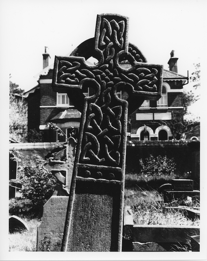

My darkroom has now been resurrected and this is the first print I've made in 22 years. Experimenting with different contrast filters. This is grade 5. I would have like less depth of field for this photo, an error.

Good news Svenedin - glad to see you are making prints. makes me jealous, wish i could print more - only contact printing right now. Like K-G, i find darkness is great - but doesn't quite work for me in this otherwise bright scene. The G2 is way too soft. Do you have a 3.5 filter?? Or, split grade printing? Got @RalphLambrecht latest book now, and some articles on internet. Neat stuff, i am itching to jump into it.

Yes I do have a 3.5 filter and that might be the way to go. I prefer this harder imager over the soft one but it is too harsh. I could maybe expose the whole photo at grade 3.5 and then burn the cross in a bit more using a card mask with a hole in it and playing that over the cross.

Well it illustrates to any newcomer to printing how much difference there is between grade 2 and 5. In terms of what is the right grade I'd endorse what michaelorr has said. It would be very interesting to try say G3 or G3.5 to see which is the best and then try split grade to see if this gives the extra "magic" touch that no single grade or half grade can give
Svenedin, Bravo! On both the print, and the darkroom. I like the composition and detail. I also have great respect for your sense of historic stuff, so any stories that go w/ the shots will be eagerly devoured. 'Nice shot!
