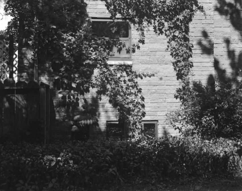

The back wall of the church on the other side of our driveway. Another test shot with APHS film trying to get close to normal contrast and tonality. Scanned the contact print at 600 DPI, which appears to be about a 6x enlargement on my monitor. Cropped out two small areas of detail and saved them to separate files. Scaled down the big scan to fit upload limits. Used a fairly long exposure because a lot of the scene was in the shade. Clear sky, sunny.
Home
Seneca 8X10 Improved View, 12" uncoated Dagor in Betax #4
12 seconds @ f22
APHS Ortho Litho Film, 2 liters water, 1 gram Metol, 8 grams Sodium Sulfite, 4-1/2 minutes continuous gentle agitation in 16 X 20 tray
Ilford MG IV FB Glossy, grade 2 filtration, D72 scratch mixed at tray dilution
